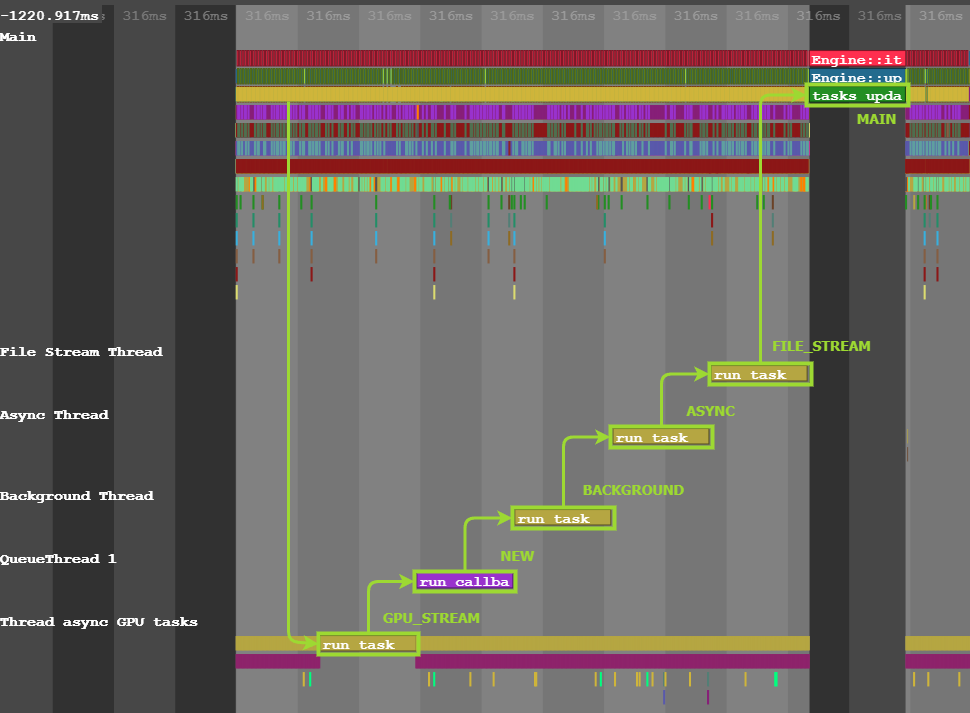

Async and Multithreaded Execution#
In addition to managing background file loading and on-demand streaming, the AsyncQueue class provides general-purpose asynchronous and multithreaded execution functionality. It enables scheduling user-defined tasks in dedicated threads, including parallel execution across multiple CPU cores.
This class supports both asynchronous and synchronous multithreaded workflows, with optional frame synchronization. It allows offloading expensive operations, such as procedural generation or complex data processing, without blocking the main thread.
To provide fine control over task placement, the AsyncQueue provides several didicated thread types via the ASYNC_THREAD enumeration:
  • BACKGROUND - background thread for long-running tasks.
  • ASYNC - general purpose async engine thread.
  • ASYNC_FRAME_POOL - async thread pool for per-frame tasks.
  • GPU_STREAM - a thread to work with GPU resources.
  • FILE_STREAM - a thread for disk I/O operations.
  • MAIN - the engine's main thread.
  • NEW - isolated thread taken from a thread pool.
AsyncQueue also provides control over task scheduling priority via the ASYNC_PRIORITY enumeration:
  • CRITICAL (0) - Highest priority. Tasks with this level are scheduled for execution before all others.
  • DEFAULT (1) - Standard priority. Used for general-purpose tasks that follow any critical ones.
  • BACKGROUND (2) - Lowest priority. These tasks are only scheduled when no higher-priority tasks are pending.
Microprofile tool: Task pipeline using all thread types.
By combining these thread types and priorities, you can design flexible execution chains that distribute workload efficiently across engine subsystems.
