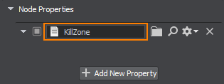

  6. Switch back to UnigineEditor and add the KillZone component to the previously created World Trigger.
