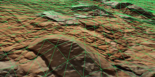

Geometry Settings
Geometry Progression |
The progression of Landscape Terrain geometry tessellation. Range of values: [0.0f, 50.0f]. The default value is 1.5f. Console access: render_landscape_terrain_geometry_progression (API control) |
Geometry Subpixel Reduction |
The minimum ratio between the polygon size (in screen space) to the size of an area in the viewport for skipping polygons rendering (the ones having a lower ratio will be removed). Notice Setting too high values may cause small but noticeable visual artifacts when the camera moves. Range of values: [0.0f, 50.0f]. The default value is 6.0f. Console access: render_landscape_terrain_geometry_subpixel_reduction (API control) |
Geometry Polygon Size |
The size of Landscape Terrain polygons defining the maximum allowed density of Landscape Terrain geometry. Range of values: [0.0f, 1000.0f]. The default value is 0.01f. Console access: render_landscape_terrain_geometry_polygon_size (API control) |
