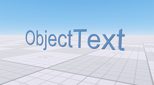

A Text object is an object representing a plain text in a 3D space. The text is rendered into a texture that is applied to a flat polygon. It uses trilinear filtering and mipmaps to correctly display the text at any distance. There is no noise influence to the object and it is not distorted by TAA.
The font can be represented as a TrueType font (TTF) or as a texture atlas with letters.

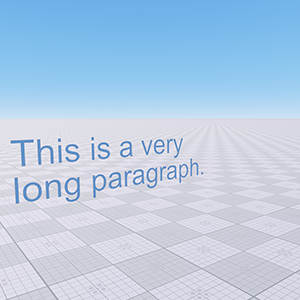

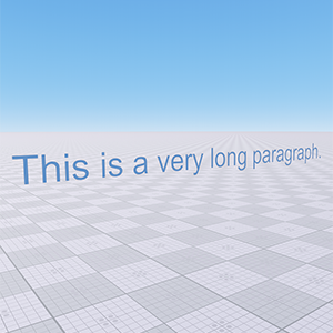

Wrap Width Text wrap width in units. The text will wrap if its physical size will be greater than the set value. If 0 is set, text wrapping is disabled.
Wrap Width = 0
Wrap Width = 5
