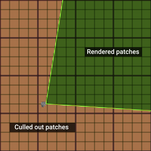

Internally, Landscape Terrain has 3 main stages of grid formation and culling, here is their schematic representation (top view), geometry levels of detail (Geometry Progression) are omitted for simplicity:
1. CPU Culling Patches
2. GPU Culling Patches
3. Tessellation Quads
You can use the Advanced settings for fine-tuning of internal operation of this system.
The default values are best suitable for the default camera FoV of 60 degrees. Using much more narrow fields may require fine tuning for the best performance.
  1. CPU Culling Patches — initial patches (tiles) tested for occlusion and visibility on the CPU side. Among other culling techniques, these patches support occlusion culling by Occluders.
    Occluders support.
    The CPU patches are to be subdivided and passed to the next stage — GPU Patches. The Culling Patch Resolution CPU value defines the number of subdivisions for CPU patches:
    • The lowest value of 2 corresponds to no subdivisions at all, i.e. all patches will be culled on the CPU side. Stick with lower values if you intend to use Occluders for polygon reduction.
    • Higher values reduce the load on CPU as more patches will be checked for visibility on the GPU side.
    Another important parameter is Culling Patch Batching defining the size of batches for culling patches. Batched culling of patches enables skipping large areas at once making it possible to operate on patches of smaller size for better culling quality and performance.

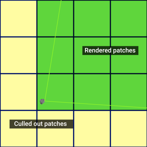

  2. GPU Culling Patches — Landscape Terrain patches, visibility of which is tested on the GPU side.
    The GPU patches are to be subdivided one more time before tessellation. The Culling Patch Resolution GPU value defines the number of subdivisions for GPU patches:
    • By lowering this value you reduce the load on CPU, more loading GPU due to less efficient culling of patches of larger size.
    • By increasing it you move more computations to CPU (more rendered primitives), reducing the load on GPU (less polygons).
    The point is to use these parameters to find a trade-off between loads on processing units in the given conditions on the target hardware. Use the Rendering Profiler to track the number of rendered primitives and triangles and achieve the best CPU and GPU timings:

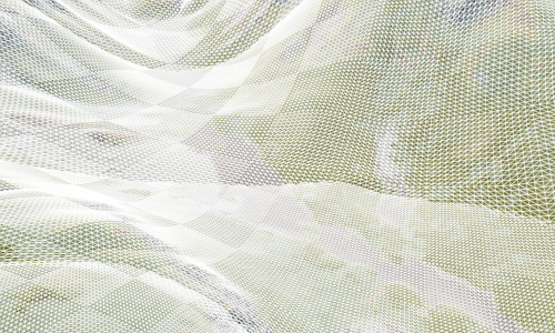

  3. Tessellation Quads — this is where Adaptive Hardware Tessellation comes into play, subdividing polygons to the target density. The last Frustum Culling optimization is applied to polygons.
All patches are constructed for all geometry LODs. Since it is impossible to match edges of culled patches of adjacent LODs, it is needed to introduce overlapping edges. In case of geometry gaps, use the following settings to increase the distance of overlap between LODs:
