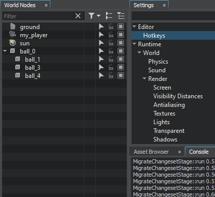

In Unigine, nodes are organized in a hierarchy that can be managed via the World Nodes window.
To open this window, choose Windows → World Hierarchy in the Menu.
World Nodes Window
As you can see, this window allows filtering nodes by name and type, collapsing and expanding nodes hierarchy (i.e., showing only the parent nodes and hiding the child ones or showing all nodes added to the world), and changing nodes hierarchy - rearranging, reparenting, cloning, renaming, deleting, and grouping the nodes.
When building a hierarchy, take into account multi-threaded update of dependent nodes.
The World Nodes window contains all nodes existing in the current world. Some nodes can be instances of the asset files: meshes, sounds, terrains, instanced nodes, or nodes stored in the *.node files.
When you add a new node to the scene via the Menu Bar (the Create menu) or by dragging it from the Asset Browser, it is automatically added to the nodes hierarchy and displayed in the World Nodes window.
