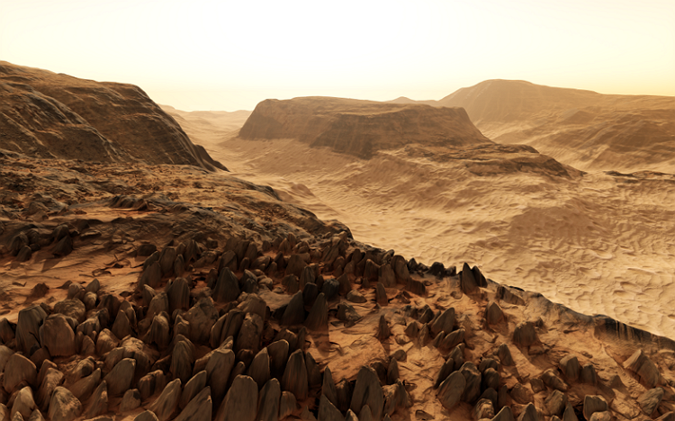

By combining multiple details under a single mask you can diversify the look of the surface a lot.
The result of combining three details under a single mask.

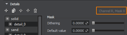

Internally each Landscape Layer Map stores its 20 masks in 5 RGBA8 mask textures. The following parameters display the info on the corresponding mask texture and can be used to access the mask via API:
Mask Texture The index of the mask texture used.
Channel The channel of the mask texture used.
