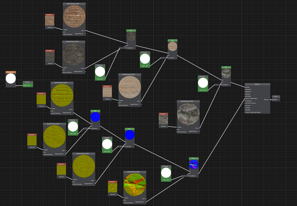

This material graph sample demonstrates how to use vertex color for texture blending when creating materials.
Vertex color data retrieved via the Vertex Color node is passed to a portal for the ease of access. 4 sets of Albedo and tangent-space Normal textures are blended with accordance to the channels of the vertex color data:
  • Each of the color channels (RGB) gets its own Linear Interpolation expression.
  • The data from the first Albedo A texture sampled by the Sample Texture node is plugged to the A port of the first Lerp node.
  • The data from each of the other three albedo Textures (B-D) sampled by the corresponding Sample Texture node is plugged to the B port of its corresponding Lerp node.
  • The first Lerp node corresponding to the Texture A plugs into the A port of the Lerp node corresponding to Texture B, with Coefficient driven by the Red channel from the vertex color (connected via the x port adapter).
  • The second Lerp node corresponding to Texture B plugs into the A port of the Lerp node corresponding to Texture C, with Coefficient driven by the Green channel from the vertex color (connected via the y port adapter).
  • The third Lerp node corresponding to Texture C plugs into the Albedo port of the master material node, with Coefficient driven by the Blue channel from the vertex color (connected via the z port adapter).
  • Four Normal maps sampled by the corresponding Sample Texture nodes have the same kind of setup of Linear Interpolation expressions.

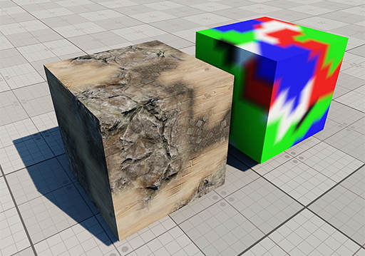

The result
