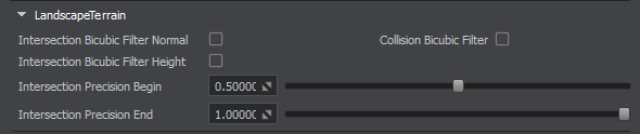

Intersections are detected with a variable precision, starting from a lower value and ending up with a higher one.
Normally there's no need to modify these values. In case of intersection detection errors you can open Landscape Terrain parameters and try tweaking start and end precision values and enable cubic filtering of textures for optimum balance, but be careful as it may significantly affect performance and accuracy:
Collision Bicubic Filter Enables bicubic filtering of textures for collision detection.
Intersection Bicubic Filter Normal Enables bicubic filtering of the normal texture for intersection detection.
Intersection Bicubic Filter Height Enables bicubic filtering of the height texture for intersection detection.
Intersection Precision Begin Starting precision of intersection detection.
Intersection Precision End Ending precision of intersection detection.
