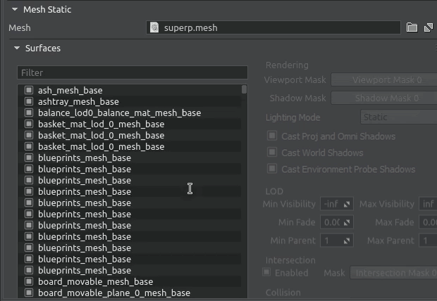

Visual representation of nodes can be changed by adjusting parameters of its surfaces on the Node tab of the Parameters window.
Only nodes of the object-related types can have surfaces.
Surfaces are organized in a hierarchy that displayed in the following section:
Surfaces Hierarchy
Surfaces can be filtered by name:
Filtering Surfaces
To change the surface parameters, select the required surface in the hierarchy and tweak its parameters. For each surface, the parameters listed below are available for editing.
