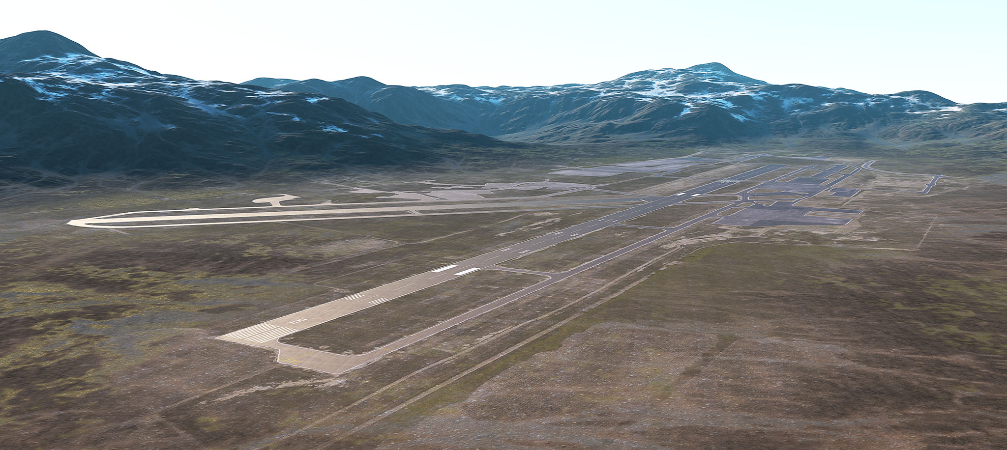

  • You can flatten the a terrain area where the airport is located via a Houdini asset. Simple asset will use a custom mask to flatten areas during landscape generation.
  • Runway itself should be created using Mesh Decals or separate geometry. Use the same way to create lines and markings on the runways.
