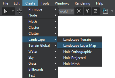

Create a new Landscape Layer Map via either of the following ways:
  • By creating a node:
    1. In the Create menu, select Landscape -> Landscape Layer Map and place the new Landscape Layer Map node in the scene.
    2. By default, the map has the white, flat and read-only landscape_layer_map_base.lmap asset set in the Landscape parameter. Click Create to create a new landscape layer asset.

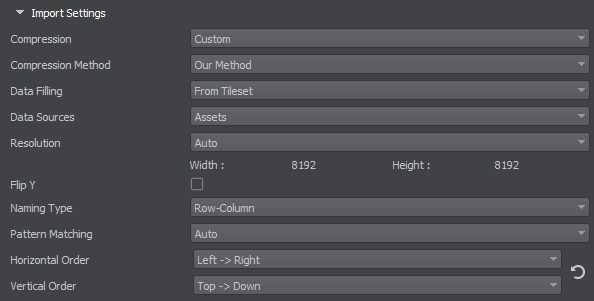

  • Generating from files:
    1. Set the Data Filling option to From Tileset.
    2. Depending on the desired way to access to the resources, choose the value of the Data Sources parameter:
      • Assets. Use available imported textures, which is a pretty good option for small and moderate terrains.
      • External Files. Provide full paths to the resources (e.g. a network drive). A better option for large terrains with extremely dense graphic data.
    3. Specify the resources: albedo and height textures (or texture tilesets) and up to 20 mask textures. In the case of using tilesets, specify only first tiles and appropriate naming patterns.
    4. Adjust other import settings. For instance, you can redefine the Resolutionof the Landscape Layer Maptextures.
    5. Click Reimportto load the provided resources.
    6. Modify the layer using Brush Editor.

Data Filling
Origin of terrain data:
  • Manual — this type of data is selected for work with brushes.
    The only setting available for this option is Resolution.
  • From Tileset — this type of data is used to add any available data sources.
Data Sources
Where data is taken from:
  • Assets — available asset files. This option is good for small terrains.
  • External files — absolute path to the file is indicated (for example, network disk). A recommended option in case of creating a huge terrain using high-density graphic data.
The engine doesn't track the changes made to external files. If there are some changes, you can update graphic data via the Reimport button.
Resolution
Resolution of maps limited only by available video memory. The following values are available:
  • Manual — set by the user. Graphic data from textures is remapped to fit the resolution.
  • Auto — automatically detected from the specified textures, the resolution of the biggest texture is used. If a tileset is specified the resulting resolution of all tiles combined will be considered.
Flip Y Flip tiles along the Y axis.
Naming Type
The source tileset layout type. The following values are available:
  • Row Column — the row-column based tileset. When set, each tile of the source tileset is determined by the row and column numbers (e.g. tileset_x0_y2.png).
  • Indexed — the index-based tileset. When set, each tile of the source tileset is determined by the index (e.g. tileset_0.png). The number of columns of the source tileset is specified in the Number of Columns field.
Pattern Matching
  • Auto — automatically select the naming pattern.
  • Manual — manually specify the naming pattern.
Pattern A string naming pattern (e.g. _x%X_y%Y for the Row Column naming type or _%X for the Indexed type).
Number of Columns The number of columns in the tileset.
Horizontal Order
Horizontal loading direction of the source tileset.
  • Left -> Right
  • Right -> Left
Vertical Order
Vertical loading direction of the source tileset.
  • Top -> Down
  • Down -> Top
