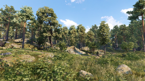

The Impostors Creator tool allows generating impostors for a single object or for objects baked into a mesh clutter:
The tool also provides special settings for generating impostors for vegetation. Impostor textures generated for vegetation ensure that when rotating a camera around any tree, its trunk will exactly match its geometry original regardless of the tree shape complexity.
