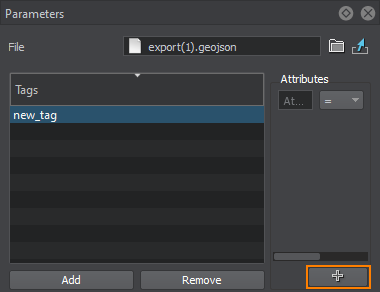

Tags are created as follows:
  1. Click the Add button in the Tags window in the Parameters panel.
    Double-click on the tag to specify a tag name. To remove a tag use Remove button.
  2. For each tag, set an attribute (or attributes) to filter certain data from the vector source. The required data is filtered using the attribute values and suitable operator. Autocomplete is available. You can type in attribute names and values.
  3. The available operators are: =, !=, >, <, ANY. ANY generates all the objects that have any value assigned for the selected attribute.
    You can also select attribute values from the Attributes table. The table opens using the sign on the right of the attribute expression.
  4. To add more attributes, use the "+" (plus) button. You can add as many attributes for one tag as necessary.
    If several attributes are set, only the data that comply with all the attributes will be selected.
    To remove a filter, use the button to the right of the attribute expression.
