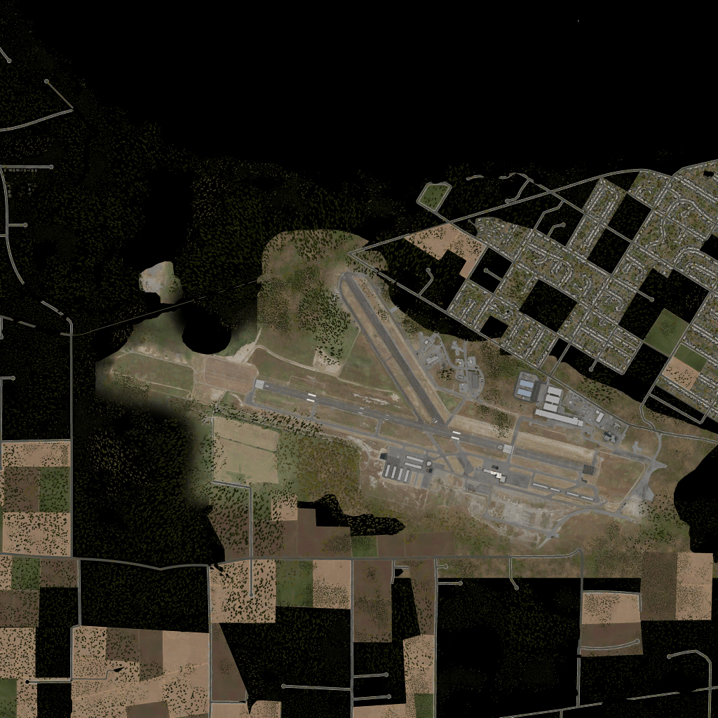

The Decal Grabber plugin splits the terrain into the specified number of tiles and then bakes each tile into a single texture. The number of the resulting textures corresponds to the number of the tiles.
One of the terrain tiles, objects of which is replaced with the grabbed decal
Texture used for the decal

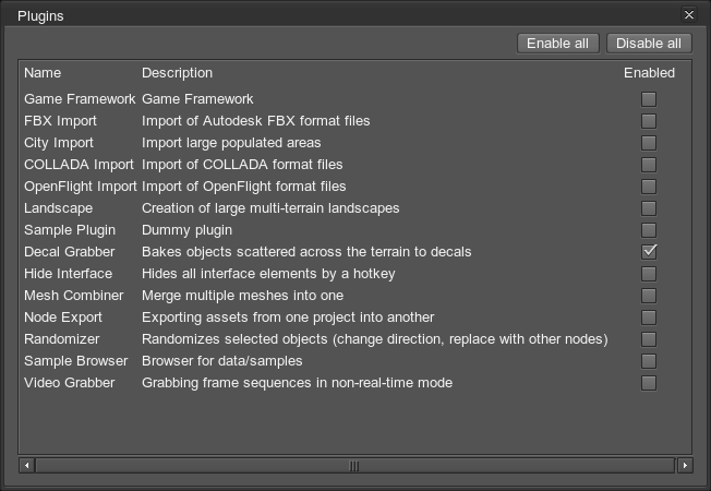

To load the Decal Grabber plugin via UnigineEditor:
  1. Run UnigineEditor.
  2. On the Menu bar, click Plugins -> Manage.
  3. In the Plugins window that opens, set the Decal Grabber plugin enabled.
    List of available plugins for UnigineEditor
  4. Close the Plugins window.
