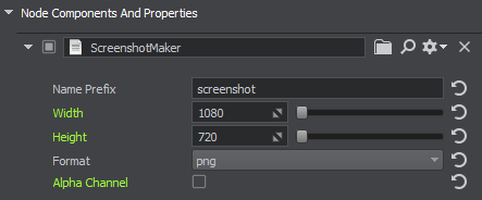

Now you have a component in your project. To be able to make screenshots, you need to do the following:
  1. Assign the ScreenshotMaker component to any node in the Editor (or create a Node Dummy and assign the component to it).
    Component assigned in the Editor
  2. Adjust settings as necessary.
    Name Prefix The prefix used in the file name.
    Width Width of the saved screenshot image.
    Height Height of the saved screenshot image.
    Format Format of the saved screenshot image.
    Alpha Channel If enabled, transparent areas are cut off.
  3. Run your app and take screenshots.
  4. Check the data/ folder of your project.
