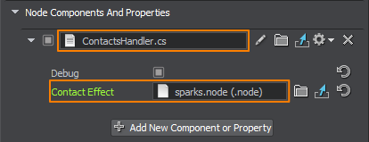

Switch to the UnigineEditor and assign the ContactsHandler component to the box node.
Specify the sparks.node in the Contact Effect field.

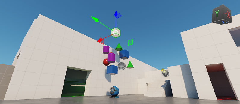

Adjust the position/rotation of the first_person_controller node to get a better initial view of the scene.
Click Run to see the result. As the box is rolling around, the physics-driven objects and collidable surfaces it hits along the way are highlighted, and contact details are displayed near the contact point. Whenever a collision occurs, it triggers an asset spawning and a slow motion effect.
