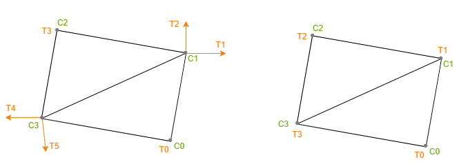

On the picture below, two examples are given (arrows are used to show normals):
Both surfaces contain 2 adjacent triangles. Here C0...C3 are coordinate vertices, T0...T5 are triangle vertices
The coordinate buffer is an array of coordinate vertices. Each coordinate vertex contains coordinates (float[3]) of the vertex. For example, the coordinate buffer for the surfaces presented on the picture above is the following:
Output
CB = [C0,C1,C2,C3]
The triangle buffer is an array of triangle vertices. For example, the triangle buffer for the surface presented on the left picture above is the following:
Output
TB = [T0,T1,T2,T3,T4,T5]
The coordinate and triangle buffers describe the same surface. Both of these buffers are required to describe the final surface. The actual amount of final vertices is the number of tvertices.
The surface presented on the right picture above consist of 2 triangles with 2 vertices (C1 and C3) which have the same normal attributes (T1 and T3) compared to the surface on the left (where C1 and C3 have more than one attribute). So the triangle buffer of vertices for the surface on the right is:
Output
TB = [T0,T1,T2,T3]

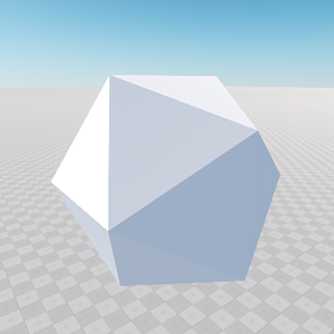

int AddIcosahedronSurface ( string name, float radius ) #
Appends a icosahedron surface to the current mesh.
Source code (C#)
// create a mesh instance
Mesh mesh = new Mesh();
// add icosahedron surface with the name "icosahedron_surface".
// the radius of the icosahedron is 1.0
mesh.addIcosahedronSurface("icosahedron_surface", 1.0f);
// create the ObjectMeshDynamic from the Mesh object
ObjectMeshDynamic dynamicMesh = new ObjectMeshDynamic(mesh);
// set the position of the mesh
dynamicMesh.WorldTransform = MathLib.Translate(new vec3(10.0f,10.0f,10.0f));
// set the name of the mesh
dynamicMesh.Name = "Dynamic Mesh";
The mesh will appear.
Arguments
  • string name - Surface name.
  • float radius - Icosahedron radius.
Return value
Added surface number.

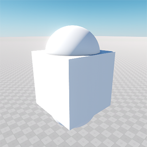

int AddMeshSurface ( string v, Mesh mesh, int surface, int target = -1 ) #
Appends a surface of the source mesh to the current mesh as a new surface.
The following example shows how to add a surface from the one mesh to another.
Source code (C#)
// create mesh instances
Mesh mesh_1 = new Mesh();
Mesh mesh_2 = new Mesh();
// add Surfaces for the added meshes
mesh_1.addCapsuleSurface("capsule_surface", 1.0f, 2.0f, 200, 100);
mesh_2.addBoxSurface("box_surface", new vec3(2.2f));
// add the surface from the mesh_2 to the mesh_1 as a new surface
// with the name "new_box_surface"
mesh_1.addMeshSurface("new_box_surface", mesh_2, 0);
// create the ObjectMeshDynamic from the mesh_1 object
ObjectMeshDynamic dynamicMesh = new ObjectMeshDynamic(mesh_1);
Arguments
  • string v - Name of the new surface added to the current mesh.
  • Mesh mesh - Source mesh to copy a surface from.
  • int surface - Number of the source mesh surface to copy.
  • int target - Number of the target of the source mesh surface. The default value is -1 (all of the surface targets).
Return value
Number of the last added surface.

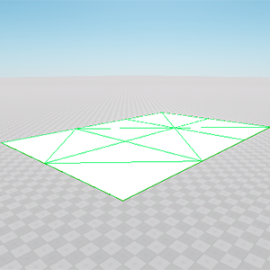

int AddPlaneSurface ( string name, float width, float height, float step ) #
Appends a plane surface to the current mesh. The plane is divided into equal squares whose size is defined by the given step.
Source code (C#)
// add the plane surface with the name "plane_surface".
// the width is 2 and the height is 3
mesh.addPlaneSurface("plane_surface", 2.0f, 3.0f, 1.0f);
The mesh will appear. You could see that the plane divided each 1 unit to equal squares.
Arguments
  • float width - Plane width.
  • float height - Plane height.
  • float step - Step of surface subdivision (vertical and horizontal).
Return value
