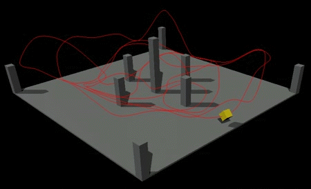

A world transform path is a succession of transformations based on an arbitrary path. The objects that are made children of the WorldTransformPath can move along with these transformations.
