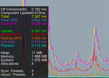

The Begin() and End() functions make the profiling scope available for both the Profiler and the Microprofile.Begin()End()函数使分析作用域可用于分析器Microprofile
If you want to use the Microprofile only, create the counter via the Profiler.BeginMicro() and Profiler.EndMicro() functions.如果您只想使用Microprofile,请通过Profiler.BeginMicro()Profiler.EndMicro()函数创建计数器。
BeginMicro() returns an identifier that should be passed to EndMicro(). Thus, several nested counters can be created.BeginMicro()返回应传递给EndMicro()的标识符。 因此,可以创建多个嵌套计数器

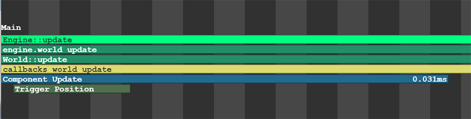

Creating Nested Counters for Profiling
创建用于分析的嵌套计数器#
To create several nested counters, you should use the Profiler.BeginMicro() and Profiler.EndMicro() functions. BeginMicro() returns an identifier that should be passed to EndMicro(). This enables to create nested and intersecting profiler counters.要创建多个嵌套计数器,应使用Profiler.BeginMicro()Profiler.EndMicro()函数。 BeginMicro()返回应传递给EndMicro()的标识符。 这样就可以创建嵌套和相交的分析器计数器。
In the following example, combination of Begin()/End() and BeginMicro()/EndMicro() is used. So, profiling of the Update() function will be available in both the Profiler and the Microprofile.在以下示例中,使用Begin()/End()BeginMicro()/EndMicro()的组合。 因此,Update()函数的分析将在探查器和Microprofile中都可用。
Microprofile.cs
private void Update()
	// start profiling
	Profiler.Begin("Component Update");
	float time = Game.Time;
	// start a nested counter
	int id_0 = Profiler.BeginMicro("Trigger Position");
	Vec3 pos = new Vec3(MathLib.Sin(time) * RADIUS, MathLib.Cos(time) * RADIUS, 0.0f);
	// stop the counter
	Profiler.EndMicro(id_0);
	trigger.Enabled = pos.x > 0.0f || pos.y > 0.0f;
	trigger.WorldPosition = pos;
	// stop profiling
	Profiler.End();
