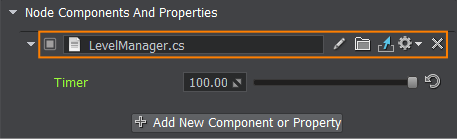

  3. Create a new Dummy Node called "level_manager" and place it somewhere in the world.创建一个名为 "level_manager" 的新 虚拟节点,并将其放置在世界某处。
  4. Add the LevelManager component to the level_manager node.LevelManager组件添加到level_manager节点。
