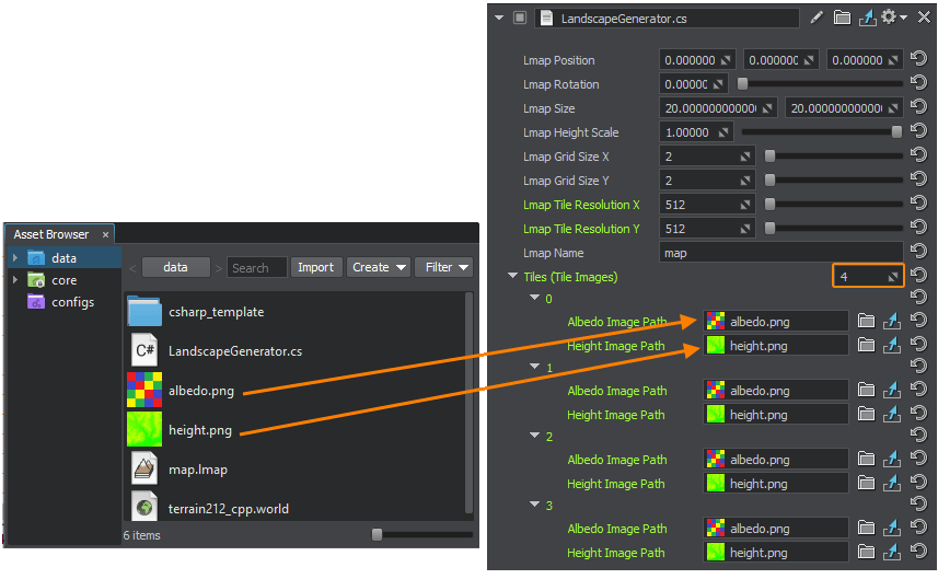

As the component is assigned, configure its settings in the Parameters window:组件分配,配置其设置Parameters窗口:
LandscapeGenerator component settings
Set the number of tiles in the corresponding field and drag albedo.png and height.png files to the Albedo Image Path and Height Image Path fields of the component.在相应的字段中设置tiles的数量,并将albedo.pngheight.png文件拖动到组件的Albedo Image PathHeight Image Path字段。
Now you can launch your application via the Run button right in UnigineEditor.现在,您可以启动应用程序通过在UnigineEditor Run按钮。

Let us modify the Heights and Albedo data of the terrain, so we need two custom maps for that. Save the following images to your computer and drag them to the Asset Browser window to add them to your project (just like you did before for the terrain's Albedo and Height maps):让我们修改地形的高度反照率数据,为此我们需要两个自定义地图。保存以下图片到你的电脑,并将它们拖到Asset Browser窗口,将它们添加到你的项目中(就像你之前对地形的反照率高度地图所做的那样):
自定义反照率地图 自定义高度图
自定义反照率地图 自定义高度图
Don't forget to set Image Format to R32F for your height map and set Texture Preset to Albedo (RGB — color, A — opacity) for your albedo map and reimport them with new settings.不要忘记设置Image Format R32F高度图和设置Texture Preset Albedo (RGB — color, A — opacity)反照率图和再输入新设置。
Code
