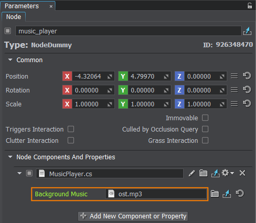

  2. Create a new Dummy Node, rename it to "music_player", and place it somewhere in the world.创建一个新的Dummy Node,重命名它为"music_player",它在世界上的地位。
  3. Add the MusicPlayer component to the music_player node.MusicPlayer组件添加到music_player节点。
  4. Assign the imported music asset (programming_quick_start/music/ost.mp3) to the Background Music field of the MusicPlayer component.指定导入的音乐资源(programming_quick_start/music/ost.mp3)的Background Music字段MusicPlayer组件。
  5. Save changes to the world, go to File->Save World or press Ctrl+S hotkey.拯救世界的变化,去File->Save World或者按Ctrl+S热键。
  6. Run the project in the UnigineEditor to check out the background music.运行项目UnigineEditor检查背景音乐。
