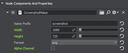

Now you have a component in your project. To be able to make screenshots, you need to do the following:现在您的项目中有了一个组件。为了能够截图,您需要做以下操作:
  1. Assign the ScreenshotMaker component to any node in the Editor (or create a Node Dummy and assign the component to it). ScreenshotMaker组件分配给编辑器中的任何节点(或创建一个Node Dummy并将组件分配给它)。
    Component assigned in the Editor
  2. Adjust settings as necessary.根据需要调整设置。
    Name Prefix The prefix used in the file name.文件名中使用的前缀。
    Width Width of the saved screenshot image.保存的截图图像的宽度。
    Height Height of the saved screenshot image.保存的截图图像的高度。
    Format Format of the saved screenshot image.保存的截图格式。
    Alpha Channel If enabled, transparent areas are cut off.如果启用,透明区域将被切断。
  3. Run your app and take screenshots.运行应用程序并截图。
  4. Check the data/ folder of your project.检查项目的data/文件夹。
