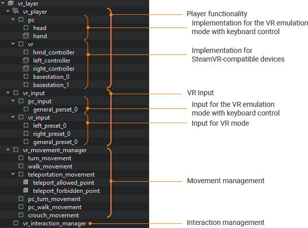

When you first open your project based on the VR Template and see a lot of different classes and components, you might get confused a bit. So, let's learn a bit more about the template structure. All components that implement the basic VR functionality are assigned to the corresponding nodes organized in the hierarchy with the vr_layer root node (see the picture below):当您第一次打开基于VR Template的项目并看到很多不同的类和组件时,您可能会感到困惑。 因此,让我们更多地了解模板结构。 实现基本VR功能的所有组件都被分配到具有vr_layer根节点的层次结构中组织的相应节点(见下图):
VRPlayer Component
VRPlayer组件#
A player is represented by the hierarchy of nodes with the vr_player node in the root (a Player Dummy camera), to which the VRPlayer component is assigned. The component implements the player's logic. The child nodes of vr_player represent models of HMDs and controllers, to which all necessary components are assigned to configure interactions and main parameters.玩家由根节点(Player Dummy摄像机)中具有vr_player节点的节点层次结构表示,该节点分配了VRPlayer组件。 组件实现玩家的逻辑。 vr_player的子节点表示HMD和控制器的模型,所有必要的组件都被分配给它们来配置交互和主要参数。
