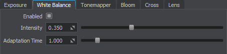

White Balance#
White balance correction eliminates the discoloration in the final image due to certain colors in the scene having more intensity and/or a higher or lower color temperature. Adaptive automatic white balance correction ensures realistic coloration of your scenes in real-time mode.
To ensure the most natural look of your scene, adjust colors of light sources by setting color temperatures. In case of heavy high-contrast discoloration (e.g., too warm and too cold lights in a dark room), the final image may look unnatural.
White balance settings
Enabled Toggles automatic white balance correction on and off.
Intensity Intensity of white balance correction.
Adaptation Time Time period in seconds, during which white balance correction is performed (0 for instant correction).
It is recommended to use lower values, when possible, to make correction process unnoticeable, otherwise it'll be slow and noticeable. However, setting too low values may result in abrupt switching of colors as the camera moves. So, adjust this parameter carefully to make transition smooth. You can set it equal to the Exposure Adaptation value.
