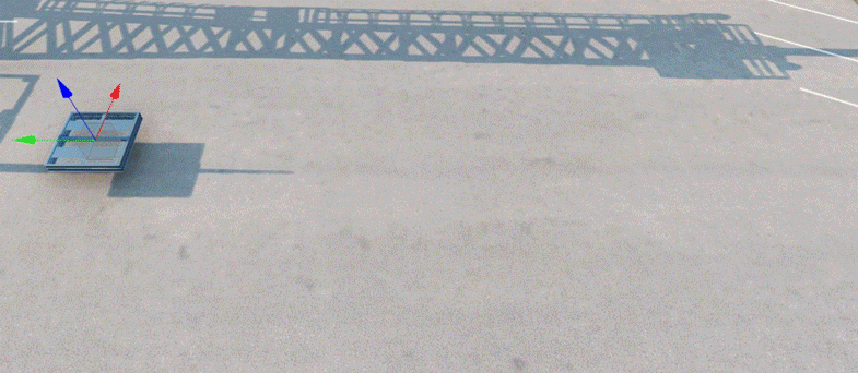

  2. Click the required node. The axes along which the node can be moved will be shown.
    Move Node
  3. Move the node:
    • If the arrow manipulator is dragged, the node can be moved along the selected axis.
    • If the rectangle manipulator is dragged, the node can be moved by two axes.
    • If the circle manipulator is dragged, the node can be moved in the screen plane.
    Move along 1 axis
    Move by 2 axes
    Move in the screen plane

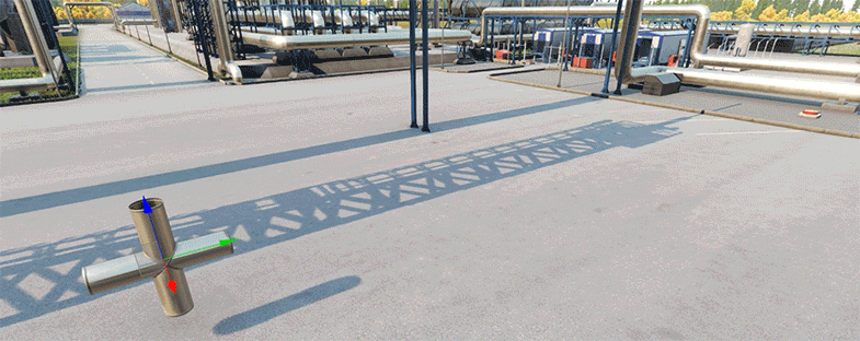

  2. Click the required node. The sphere with the axes, around which the node can be rotated, will be shown.
    Rotate node
  3. Rotate the node:
    • If an axis of the sphere is dragged, the node is rotated around the axis.
    • If the sphere is dragged, the node can be rotated freely around several axes.

    Initial position of a node
    Node dropped to surface (default settings)
