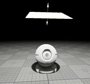

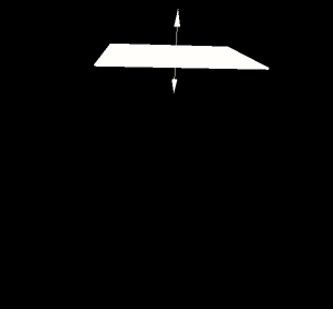

  • Dynamic. The light source provides direct realtime lighting only. It is considered disabled while light baking is being calculated, that is why the scene remains unlit when the light is turned off after light baking. No shadows are baked.
    Dynamic light source enabled. No GI is baked.Dynamic light source enabled. No GI is baked.
    Dynamic light source disabled.Dynamic light source disabled.
    Dynamic light source enabled. No GI is baked.Dynamic light source disabled.
    The Dynamic mode excludes the surface from use in static lighting and is suitable for dynamic shadows. Use this option for dynamic objects.
