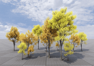

When preparing a 3D model of a tree with dense foliage, avoid creating topology for all branches and leaves; instead, it is much more efficient performance-wise to simulate fine details with textures. The main rule of models optimized for use in real-time is "the fewer polygons — the better." Following this rule is much more critical for rendering a dense forest filled with multiple types of plants and grasses.
Therefore, it is highly recommended to prepare several levels of detail (LODs) for a plant to be used at different distances from the camera.
The overall workflow of modeling a tree is as follows:
  1. Model several small branches with leaves and bake the models into texture atlases — the obtained textures are going to be your foliage textures. Here are examples of such textures:
  2. Create low-poly meshes that will represent foliage chunks, map UVs for proper texturing. The chunks do not have to be flat, you can experiment with the shape and bend of meshes. It is also important to prepare at least 3 LODs, so make sure to optimize the meshes of LODs to the full extent:
    Branches
    Foliage LODs.
  3. Create the trunk with large branches and levels of detail for it. Prepare and assign necessary textures and materials.
    Trunk LODs.
    Also, it is recommended to transfer normals from the trunk to the adjoined vertices of branches to make a more natural look of joints:
    Adjusted normals of branches at joints provide a more natural look.
  4. Scatter the LODs of foliage chunks over branches of the corresponding trunk LODs forming the tree crown:
    Tree LODs
    The fact that the same number of chunks is used on all LODs may result in a higher polygon count. However, this approach has a number of advantages:
    • The high diversity of branches makes it possible to create more realistic plants;
    • A better, almost seamless transition between LODs. All elements can be adjusted at any time to get rid of any inconsistencies;
    • A more permissive art pipeline enables the artists to collect trees of different sizes and ages out of the same chunks;
    • Accurate work of post effects even on the lowest LODs (SSAO, SSGI, etc.).
  5. It is also recommended to create a separate low detail foliage LOD to simplify shadow casting. You can duplicate the lowest LOD and optimize it even more for this purpose and configure shadow casting in UNIGINE.

Finally, by combining several clutters for different types of trees, bushes, and grass, you get a diverse look of vegetation.
Combination of several Mesh Clutters for diverse vegetation.
