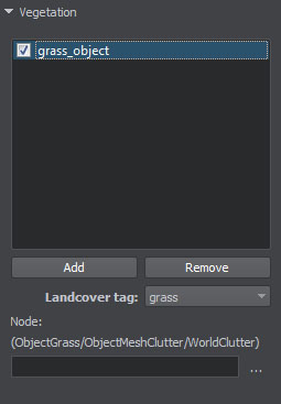

  1. On the Sources panel, select the Masks (Landcover) data source type and the following settings will be displayed in the Vegetation tab of the Parameters panel.
  2. Add a basic object for generation by clicking Add button and specify object's name. You can add as many objects as nesessary.
  3. For each basic object specify the following parameters:
    Node The path to the basic mesh object's *.node file.
    Landcover tag The tag for the selected landcover object from the list of tags specified at the second step.
  4. Check the basic objects you added at the previous step to be generated.
    If you are going to update some of the existing vegetation objects, check only the changed ones. At that, the other objects will remain the same after terrain generation.
  5. Now all necessary basic objects are specified and bound to tags.
