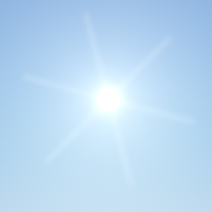

Enabled The value indicating if cross flares are enabled. Enabled by default.
Console access: render_cross
Color The color of the cross flares. To use this option, rendering of cross flares should be enabled.
vec4_one - default value (white)
Console access: render_cross_color
Scale The color multiplier.cross color scale — a multiplier for the color of cross flares. Higher values produce more pronounced flares. To use this option, rendering of cross flares should be enabled.
Range of values: [0.0f, inf]. The default value is 1.0f.
Console access: render_cross_scale
Scale = 0.4 (by default)
Scale = 0.7
Shafts The number of shafts in a cross flare. High number of flares can cause a FPS drop on low-performance hardware. To use this option, rendering of cross flares should be enabled.
Range of values: [2, 32]. The default value is 4.
Console access: render_cross_shafts
Shafts = 2 (minimum)
Shafts = 6 (by default)
Shafts = 32 (maximum)
Length The length of a cross flare relative to the screen width. Increasing this value also leads to fading of the shafts across their length. To use this option, rendering of cross flares should be enabled.
Range of values: [0.0f, 2.0f]. The default value is 0.2f.
Console access: render_cross_length
Length = 0.2 (by default)
Length = 0.4
Angle The cross flares orientation angle. To use this option, rendering of cross flares should be enabled.
Range of values: [-inf, inf]. The default value is 45.0f.
Console access: render_cross_angle
Angle = 45 (by default)
Angle = 90
