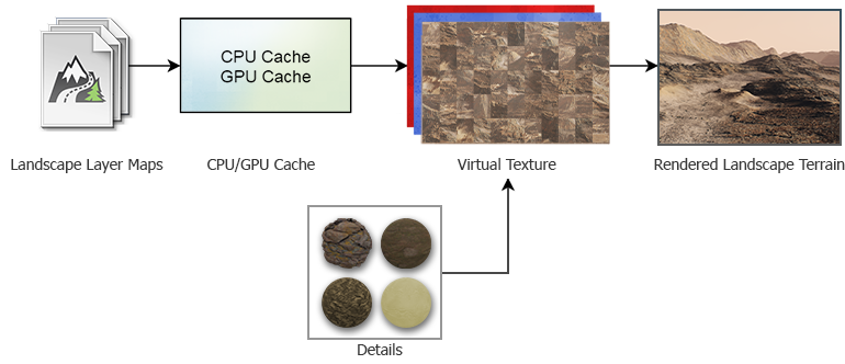

The overall life cycle of graphic data can be thought of as follows:
  1. The system determines the tiles that are currently visible in the viewport, their spatial size and their highest available mip-level depending on the distance, terrain density limits and streaming settings.
  2. The required graphic data of requested tiles of base textures is loaded from .lmap assets in chunks of 128×128 pixels and cached in the RAM (CPU cache) to be used in intersection calculations and physics.
  3. The acquired data is uploaded to the GPU and cached in the video memory, if necessary (GPU cache).
  4. The data of several Landscape Layer Maps (Albedo, Height and Mask textures) is blended according to the Blending Settings.
  5. The base textures are blended with textures of the details (if any).
  6. The final textures for each of three Landscape Terrain components (Albedo, Normal and Height) are written into the Virtual Texture replacing the oldest chunks.
  7. The result is rendered in the viewport with due regard for Adaptive Hardware Tessellation and displacement.
  8. The textures are replaced by newer data in the cache when no longer needed.
The life cycle of Landscape Terrain graphic data.
