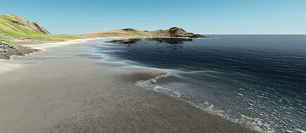

Shoreline Wetness The value indicating if the wetness effect for objects near the shoreline is enabled. Enabled by default.
Console access: render_water_shoreline_wetness
