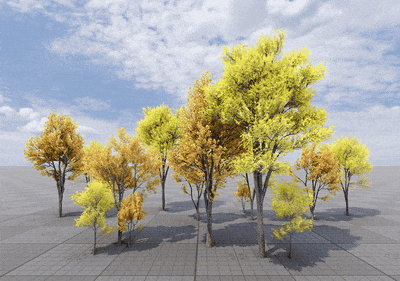

  4. Scatter the LODs of foliage chunks over branches of the corresponding trunk LODs forming the tree crown:
    Tree LODs
    The fact that the same number of chunks is used on all LODs may result in a higher polygon count. However, this approach has a number of advantages:
    • The high diversity of branches makes it possible to create more realistic plants;
    • A better, almost seamless transition between LODs. All elements can be adjusted at any time to get rid of any inconsistencies;
    • A more permissive art pipeline enables the artists to collect trees of different sizes and ages out of the same chunks;
    • Accurate work of post effects even on the lowest LODs (SSAO, SSGI, etc.).

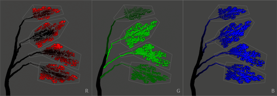

Geometry Vertex Color Based#
This recommended approach providing the best control over foliage implies that leaves are rendered as polygons, and vertex colors are used for animation.
Vegetation movements are defined by RGB channels of vertex colors as follows:
Red channel is used for animation of smaller or peripheral parts of vegetation (leaves). Bright parts are animated, and dark parts are stiff.
Green channel is used to define the movement order for branches in order to desynchronize them. The movement sequence starts from the brightest element to the darkest.
Blue channel is used to define which parts of branches can be bent. Brighter parts indicate bendable portions, and darker parts — stiff portions.
The animation parameters control vertices movement:
It is also a regular practice to animate branches using this technique even if they are attached to the trunk:
The Green and Blue channels define the movement of vertices; the Red channel is not used for branches.
At that, related surfaces must have the same vertex colors on adjacent vertices and identical animation parameters in order to synchronize their movement:
The colors of adjacent vertices of the trunk and foliage are the same, so the geometry stays connected when animated.
Geometry Vertex Color Based leaves animation.

Finally, by combining several clutters for different types of trees, bushes, and grass, you get a diverse look of vegetation.
Combination of several Mesh Clutters for diverse vegetation.
