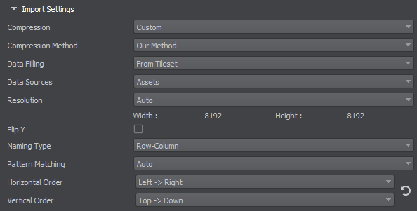

Import Settings#
Import Settings are the settings of the .lmap asset associated with the Landscape Layer Map node.
There is a set of buttons to work with import settings:
Restore Defaults Reset all settings to the default values.
Apply Save and apply changes to the import parameters without reloading graphic resources. Click Apply after selecting a compression method option.
Reimport Reload all graphic resources with respect to the specified import parameters. Click Reimport after making any changes to the import settings to apply them.
Cancel Discard changes made to the import parameters.
Import settings:
Compression
Compression options:
  • Off — compression is disabled (maximum file size).
  • Lossless — lossless compression Our Method is enabled, all lossy compressions are disabled.
  • Lossy — lossless compression Our Method is enabled, all lossy compressions are enabled for all data (Lossy Compression checkboxes are checked).
    Use of Lossy compression will lead to quality deterioration every time the data is compressed.
  • CustomCompression Method combo box appears below, Lossy Compression checkbox appears for Albedo and Masks.
Compression Method
Compression method options:
  • Our Method — recommended. UNIGINE compression method optimized for compressing 2D and 3D textures. It provides better results than LZ4 and Zlib without deteriorating the quality.
  • Zlib — for high compression ratio (can provide up to 2 times higher compression ratio, but takes up to 20 times longer).
  • LZ4 — temporary option, planned to be removed in the upcoming releases.
Data Filling
Origin of terrain data:
  • Manual — this type of data is selected for work with brushes.
    The only setting available for this option is Resolution.
  • From Tileset — this type of data is used to add any available data sources.
Data Sources
Where data is taken from:
  • Assets — available asset files. This option is good for small terrains.
  • External files — absolute path to the file is indicated (for example, network disk). A recommended option in case of creating a huge terrain using high-density graphic data.
The engine doesn't track the changes made to external files. If there are some changes, you can update graphic data via the Reimport button.
Resolution
Resolution of maps limited only by available video memory. The following values are available:
  • Manual — set by the user. Graphic data from textures is remapped to fit the resolution.
  • Auto — automatically detected from the specified textures, the resolution of the biggest texture is used. If a tileset is specified the resulting resolution of all tiles combined will be considered.
Flip Y Flip tiles along the Y axis.
Naming Type
The source tileset layout type. The following values are available:
  • Row Column — the row-column based tileset. When set, each tile of the source tileset is determined by the row and column numbers (e.g. tileset_x0_y2.png).
  • Indexed — the index-based tileset. When set, each tile of the source tileset is determined by the index (e.g. tileset_0.png). The number of columns of the source tileset is specified in the Number of Columns field.
Pattern Matching
  • Auto — automatically select the naming pattern.
  • Manual — manually specify the naming pattern.
Pattern A string naming pattern (e.g. _x%X_y%Y for the Row Column naming type or _%X for the Indexed type).
Number of Columns The number of columns in the tileset.
Horizontal Order
Horizontal loading direction of the source tileset.
  • Left -> Right
  • Right -> Left
Vertical Order
Vertical loading direction of the source tileset.
  • Top -> Down
  • Down -> Top
