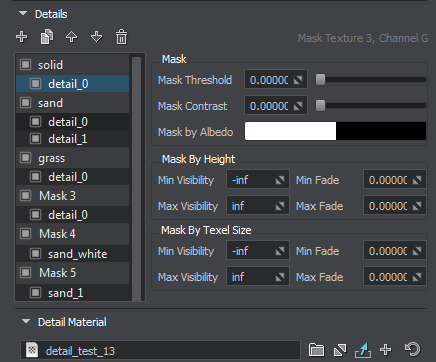

Details细节#
The Landscape Terrain enables you to add up to 1024 details to a mask making it possible to create a pretty detailed and diverse look of the landscape. In terms of optimization, minimizing the number of details and textures is a way to faster rendering.Landscape Terrain 使您最多可以添加1024细节一个面具,可以创建一个非常详细和多样化的景观外观。在优化方面,尽量减少细节和纹理的数量是加快渲染速度的一种方式。
The textures of details are loaded at the world startup and kept in the video memory to be blended with the base textures of the Landscape Terrain when rendering. You can specify a lower resolution for the corresponding textures of all detail materials by tweaking the following parameters:细节纹理在世界启动时加载并保存在显存中,以便在渲染时与地形地形的基础纹理混合。您可以通过调整以下参数为所有细节材质的相应纹理指定较低的分辨率:
