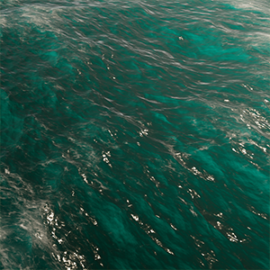

As the water object uses the screenspace projected grid for the water surface of the infinite size, it is recommended to use only one (1) water object in the scene.
Ocean created with the Global Water Object
