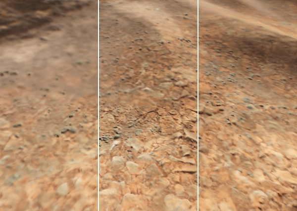

During rasterization the renderer selects the mip-level of textures according to the distance to the camera, as well as to the angle of the surface to the camera, i.e. the screen size of the polygon: distant polygons and polygons that are not faced right to the camera are rendered at a lower quality. The Texture Filtering mode controls the way of treating such situations, it has the following presets:
  • Low — use the lower mip-level. This option has the best performance but low quality: there is a noticeable edge of mip-levels change.
  • Medium — use the higher mip-level. Though the quality is better, the edge still remains. This option has a moderate effect on the performance.
  • High — linearly interpolate adjacent mip-levels. This option uses appropriate mip-levels and interpolates pixels, so the edge between mip-levels disappears. This is the most performance-consuming mode.
Comparison of filtering modes: Low, Medium, High. Settings were degraded for obviousness.
The Low and Medium modes may provide slight flickering due to low filtering quality. Use TAA to get rid of perceptible artifacts. If your project requires TAA to be disabled, try decreasing overall detail quality.
