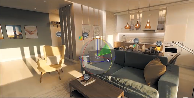

基于体素的GI
Voxel-Based Global Illumination is a static GI technique projecting a precalculated 3D lighting map into a box-shaped voxel volume. This approach uses spatial modulation, that is why there is no need in UV coordinates.基于体素的全局照明是一种静态GI技术,可将预先计算的3D光照图投影到盒状体素体中。这种方法使用空间调制,这就是为什么不需要UV坐标的原因。
Voxel-based GI is provided by Voxel Probes.基于体素的GI由Voxel Probes提供。
Light baking is performed using the Bake Lighting Tool.使用Bake Lighting Tool进行光烘焙。

  1. Create and place one or several Voxel Probes at the places where the lighting remains relatively static (e.g. interiors, outdoor buldings, immovable objects).
    Place voxel probes inside other voxel probes to create insets defining the areas that require higher detail. Note that voxel probes with the additive blending mode enabled cannot be used for this purpose, as they are blended instead of replacing each other.Place voxel probes inside other voxel probes to create insets defining the areas that require higher detail. Note that voxel probes with the additive blending mode enabled cannot be used for this purpose, as they are blended instead of replacing each other.
    在灯光保持相对静止的地方(例如室内,室外建筑物,不动的物体)创建并放置一个或多个Voxel Probes
    Place voxel probes inside other voxel probes to create insets defining the areas that require higher detail. Note that voxel probes with the additive blending mode enabled cannot be used for this purpose, as they are blended instead of replacing each other.将体素探针放置在其他体素探针内部,以创建定义需要更高细节的区域的插图。请注意,启用了添加剂混合模式的体素探针不能用于此目的,因为它们被混合而不是彼此替换。
