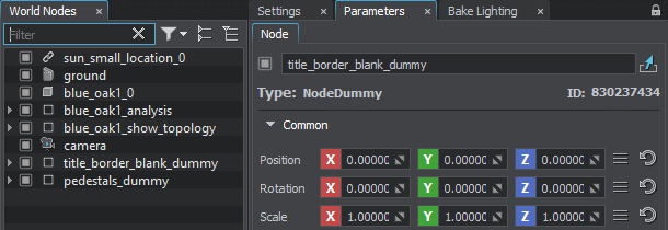

In Unigine, nodes are organized in a hierarchy that can be managed via the World Nodes window. 在Unigine中,节点以等级制度可以通过World Nodes窗口进行管理。
World Nodes WindowWorld Nodes视窗
This window contains all nodes existing in the current world. Some nodes can be instances of the asset files: meshes, sounds, terrains, instanced nodes, or nodes stored in the *.node files. 此窗口包含当前世界中存在的所有节点。一些节点可以是资产文件:网格,声音,地形,实例化节点或*.node文件中存储的节点。
When you add a new node to the scene via the Menu Bar (the Create menu) or by dragging it from the Asset Browser, this node is automatically added to the nodes hierarchy and displayed in the World Nodes window. 通过 将新节点添加到场景中时菜单栏Create菜单)或将其从Asset Browser拖动,该节点将自动添加到节点层次结构中,并显示在World Nodes窗口中。
The World Nodes window allows filtering nodes by name and by type, collapsing nodes hierarchy (showing only the parent nodes and hiding the child ones), expanding nodes hierarchy (showing all nodes added to the world), rearranging, reparenting, cloning, renaming, deleting, and grouping the nodes. 0#phl窗口允许按名称和类型过滤节点,折叠节点层次结构(仅显示父节点并隐藏子节点),扩展节点层次结构(显示添加到世界的所有节点),重新整理复育克隆重命名删除中, 和分组节点。
To open the World Nodes window, choose Windows -> Toggle World Hierarchy in the Menu. 要打开World Nodes窗口,请在菜单中选择Windows -> Toggle World Hierarchy
When building a hierarchy, take into account multi-threaded update of dependent nodes.建立层次结构时,请考虑到依赖节点的多线程更新

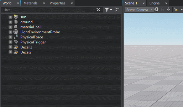

Rearranging Nodes重新排列节点#
To move a node to a specific position in the hierarchy, drag it with the left mouse button pressed. 要将节点移动到层次结构中的特定位置,请按住鼠标左键将其拖动。
Moving a Node in Hierarchy在层次结构中移动节点
The position in the hierarchy, where the node will be placed, is highlighted with the white line:用白线突出显示将在其中放置节点的层次结构中的位置:
Highlighted Position突出位置
