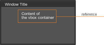

reference#
A flag indicating whether a container is referenced by the reference tag. Acceptable values:
  • no reference flag or 0 (default)
    The container will be shown in the UI as usual.
  • 1
    The container will not be shown in the UI and you will be able to refer it by using the reference tag.

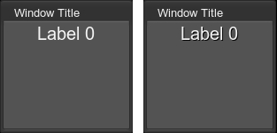

  • outline
    Whether the text should be outlined. The default is 0 (boolean), which corresponds to no outlining.
    no outline / outlined
    The outlined text is represented on the right picture.
    Source code (XML)
    <label><text size="20" outline="1">Label 0</text></label>

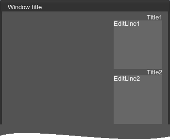

align#
Unlike the align attribute of the text tag, thealign tag can be applied to a group of widgets.
Attributes:
  • align
    Acceptable values are center, left, right.
For example:
Source code (XML)
<align align="right">
	<label><text>Title1</text></label>
	<edittext name="Test::edittext_1" export="1" width="100" height="100">
		<text>EditLine1</text>
	</edittext>
