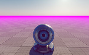

Background Color The background color vector. The Alpha channel of this color sets background transparency: lower alpha channel values produce darker background color. This parameter allows creating colored transparent background instead of rendering an environment cubemap. However, if the environment cubemap is rendered, the background color will always be rendered over the environment.
Console access: render_background_color (API control)

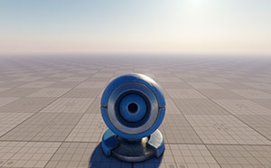

Black background color
Default Background Color
Blue background color
Blue Background

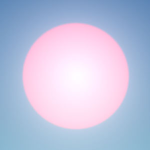

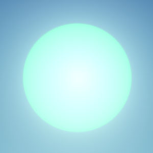

Sun
A texture that sets the Sun in the sky. On the picture below, the Sun Size is increased to demonstrate how the textures are applied:

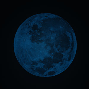

Moon
A texture that sets the Moon in the sky. On the picture below, Moon Size and Moon Intensity are increased to demonstrate how the textures are applied:
Sun Color
Color multiplier for the Sun texture in the RGBA format. By default, the color is white.
