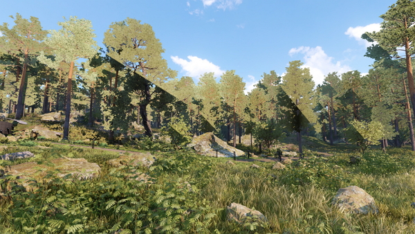

Impostors Creator tool is used to create impostors that are rendered instead of real objects at large distances. Impostors are usually used to optimize performance if you use mesh clutters: at a certain distance from the camera, they are rendered instead of the real geometry.Impostors Creator工具用于创建伪造的冒名顶替者,而不是远距离的真实对象。如果使用网格杂波,通常会使用伪装者来优化性能:在距相机一定距离的情况下,伪装者会被渲染,而不是真实的几何体。
Impostors Creator ToolImpostors创作者工具
To open the Impostors Creator tool, choose Tools -> Impostors Creator in the Menu Bar.要打开Impostors Creator工具,请在菜单栏中选择Tools -> Impostors Creator
The Impostors Creator tool allows generating impostors for a single object or for objects baked into a mesh clutter:Impostors Creator工具可以为单个物体或烤成网状杂物的物体生成冒名顶替者:
The tool also provides special settings for generating impostors for vegetation. Impostor textures generated for vegetation ensure that when rotating a camera around any tree, its trunk will exactly match its geometry original regardless of the tree shape complexity.该工具还提供了用于生成植被冒名者的特殊设置。为植被生成的伪造者纹理可确保在围绕任何树木旋转摄像机时,其树干将完全匹配其原始几何形状,而与树木形状的复杂程度无关。
