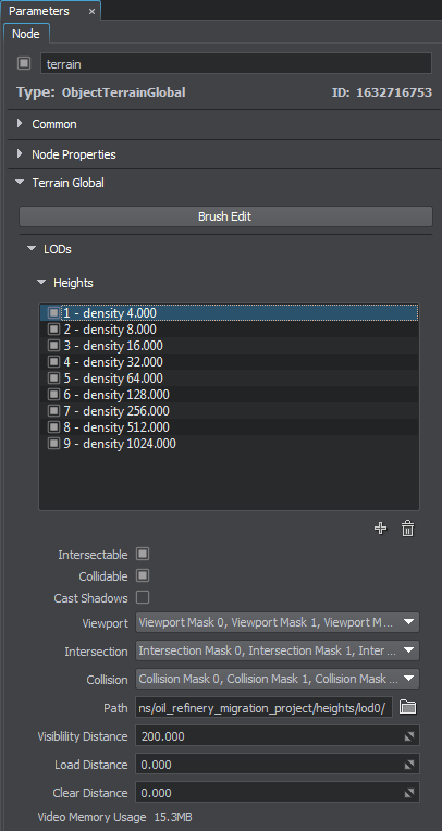

Height Data#
Parameters of a certain LOD of the height data layer can be accessed via the LODs section of the Node tab in the Parameters window.
You can add a new height or remove an existing one by clicking or respectively. Added heights can be toggled on and off by using checkboxes inside the Height window.
Parameters window, Node tab, LODs section.
The following parameters are available for the Height LODs:
  • Intersectabletoggle intersection detection for the current height LOD on and off.
  • Collidable — toggle collision detection for the current height LOD on and off.
  • Cast Shadow — toggle shadow casting for the current height LOD on and off. You can use this parameter for performance optimization: disable shadow casting for high-poly LODs and enable for low-poly ones.
    When only the low-poly LOD casts shadows, the high-poly LOD may be shadowed in areas where it shouldn't be. To reduce this effect, use the Shadow Offset parameter of the terrain material.
  • Viewportviewport mask for the current height LOD.
  • Intersectionintersection mask for the current height LOD.
  • Collisioncollision mask for the current height LOD.
  • Path — path to a folder, in which the current height LOD is stored.
  • Visibility distance — the distance starting from which the tiles of the current height LOD become visible.
  • Load distance — the distance starting from which the tiles of the current height LOD are loaded into memory.
  • Clear distance — the distance starting from which the tiles of the current height LOD are removed from memory.
  • Video memory usage — memory consumption of the current height LOD.

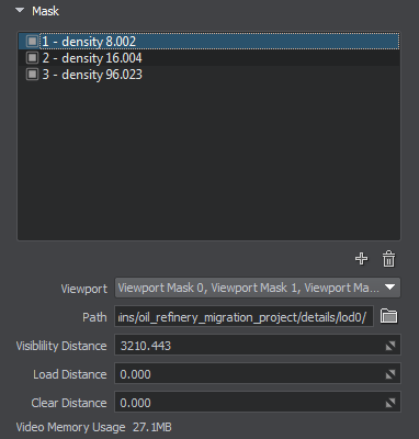

Masks Data#
Parameters of a certain LOD of the masks data layer can be accessed via the Mask section of the Node tab in the Parameters window.
You can add a new LOD or remove an existing one by clicking or respectively. Added mask layers can be toggled on and off by using checkboxes inside the Mask window.
Parameters window, Node tab, Mask section.
The following parameters are available for the Mask LODs:
  • Viewportviewport mask for the current masks LOD.
  • Path — path to a folder, in which the current masks LOD is stored.
  • Visibility Distance — the distance starting from which the tiles of the current masks LOD become visible.
  • Load Distance — the distance starting from which the tiles of the current masks LOD are loaded into memory.
  • Clear Distance — the distance starting from which the tiles of the current masks LOD are removed from memory.
  • Video Memory Usage — memory consumption of the current masks LOD.

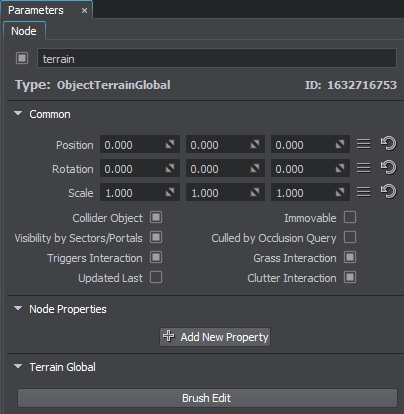

Editing a Global Terrain#
You can edit any height, albedo or mask LOD of the Global Terrain object using the Terrain Editor tool.
To start editing the current terrain, click Brush Edit in the Terrain Global section of the Node tab in the Parameters window.
The Terrain Editor window will be displayed.
When you're done editing the terrain, click either Apply to apply all changes and exit the terrain editor, or Cancel to discard your changes.
Please refer to the Editing Global Terrain article to learn more about manual terrain modification with brushes.

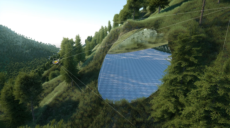

Creating Decal-Based Holes#
In some cases you may need to cut out an area of the terrain surface. For this purpose the Decal-Based Holes feature is supported by Global Terrain.
Place any decal (orthographic, projected or a mesh one) with the decal_terrain_hole_base material assigned over the desired location.
This will create a hole in the terrain surface.
A decal-based hole in a terrain with a circle mask applied.
Accurate intersection with decal-based terrain holes is supported, enabling collision detection as well as all corresponding Editor features such as selection, snapping to surface, etc.
Intersection and collision accuracy significantly depends on the terrain polygon count. The higher the number of polygons, the higher the accuracy.
