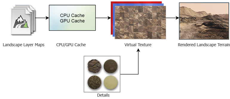

The overall life cycle of graphic data can be thought of as follows:图形数据的整体生命周期可以这样想:
  1. The system determines the tiles that are currently visible in the viewport, their spatial size and their highest available mip-level depending on the distance, terrain density limits and streaming settings.系统根据距离、地形密度限制和流设置确定当前在视口中可见的图块、它们的空间大小和最高可用 mip 级别。
  2. The required graphic data of requested tiles of base textures is loaded from .lmap assets in chunks of 128×128 pixels and cached in the RAM (CPU cache) to be used in intersection calculations and physics.请求的基础纹理图块所需的图形数据从 .lmap 资产以128×128 像素的块加载,并缓存在 RAM(CPU 缓存)中,以用于相交计算和物理。
  3. The acquired data is uploaded to the GPU and cached in the video memory, if necessary (GPU cache).获取的数据会上传到 GPU 并在必要时缓存在视频内存中(GPU 缓存)。
  4. The data of several Landscape Layer Maps (Albedo, Height and Mask textures) is blended according to the Blending Settings.几个 Landscape Layer MapsAlbedo, HeightMask 纹理)的数据根据混合设置.
  5. The base textures are blended with textures of the details (if any).基础纹理与细节(如果有的话)。
  6. The final textures for each of three Landscape Terrain components (Albedo, Normal and Height) are written into the Virtual Texture replacing the oldest chunks.三个 Landscape Terrain 组件(Albedo, NormalHeight)中每一个的最终纹理都被写入虚拟纹理中,替换最旧的块。
  7. The result is rendered in the viewport with due regard for Adaptive Hardware Tessellation and displacement.结果在视口中渲染,并适当考虑了自适应硬件细分和置换。
  8. The textures are replaced by newer data in the cache when no longer needed.当不再需要时,纹理会被缓存中的较新数据替换。
The life cycle of Landscape Terrain graphic data.Landscape Terrain 图形数据的生命周期。

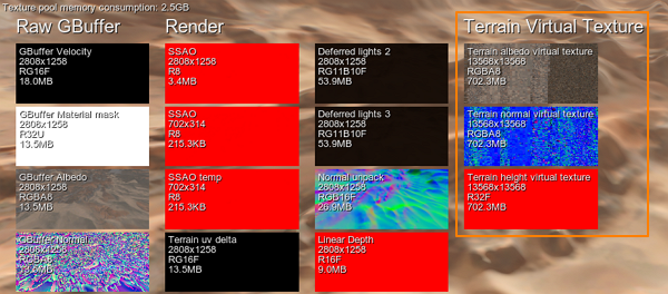

Virtual Texture虚拟纹理#
The final textures for tiles of the Landscape Terrain are written to the Virtual Texture components (Albedo, Normal and Height). Increase the Texture Memory Size value to ensure that the Virtual Texture provides enough capacity to store the loaded high-detail texture chunks.Landscape Terrain 的瓦片的最终纹理被写入虚拟纹理组件(Albedo, NormalHeight)。增加 Texture Memory Size 值以确保虚拟纹理提供足够的容量来存储加载的高细节纹理块。
The components of the Landscape Terrain Virtual Texture.Landscape Terrain 虚拟纹理的组件。
With a lower size the Virtual Texture requires less video memory but doesn't provide enough capacity to store all the required data resulting in poor performance, low detail level and fast flickering of the Landscape Terrain surface due to continuous reloading of tiles.由于尺寸较小,虚拟纹理需要较少的视频内存,但无法提供足够的容量来存储所有需要的数据,从而导致性能不佳、细节水平低以及由于连续重新加载瓷砖而导致景观地形表面快速闪烁。
