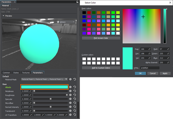

  5. Create 3 new materials in the UnigineEditor: in the Materials window, right-click the mesh_base material and choose Create Child. By default, the created materials are named as specified in the previous code snippet (mesh_base_*). Move the materials to the data/materials folder of your project (create this folder if it doesn't exist).在 UnigineEditor 中创建 3 个新材质:在 Materials 窗口中,右键单击 mesh_base 材质并选择 Create Child。 默认情况下,创建的材质按照前面的代码片段 (mesh_base_*) 中的指定命名。 将材料移动到项目的 data/materials 文件夹(如果该文件夹不存在,请创建此文件夹)。
  6. Select materials one by one in the Materials window and in the Parameters window switch to the Parameters tab and click on the color field near Albedo to choose different colors for the objects via the color picker.Materials窗口中一一选择材质,在Parameters窗口切换到Parameters选项卡点击Albedo附近的色域进行选择 通过颜色选择器为对象设置不同的颜色。
