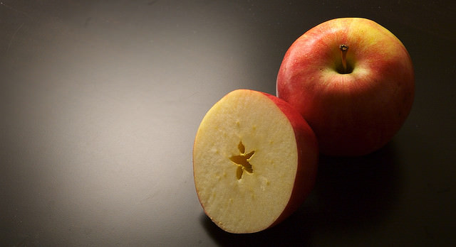

Diffuse reflection (also known as diffuse light) is an effect of reflection of light from a surface in all directions at many different angles.
Apple one (flickr.com) / CC BY-SA 2.0
All dielectrics have this effect.

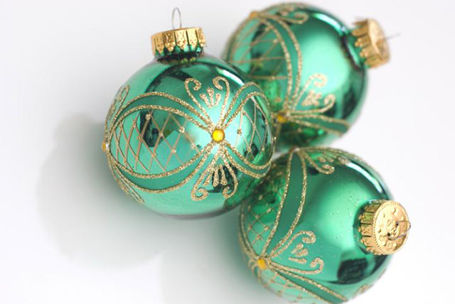

Reflection (also known as specular light) is an effect of light reflection, when the light is reflected on the opposite side with the same angle at which it has fallen on a surface.
Both metals and dielectrics have that effect.
Green Christmas Balls (christmasstockimages.com) / CC BY 3.0
Ambient reflection is simulated by using cubemaps while light source reflection is calculated by using BRDF formula that describes the behavior of the glint on the surface. Before the BRDF, the Blinn-Phong was used which is a simplified version of BRDF. Now the more physically correct BRDF that is used is called GGX.

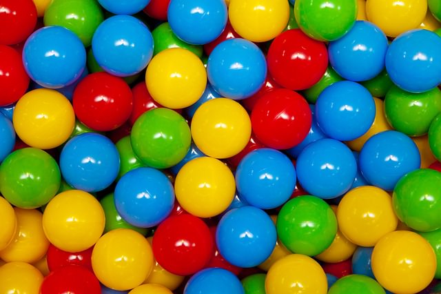

Dielectrics#
Dielectrics (also known as insulators) are materials with diffuse scattering and reflection with low intensity. Reflections on dielectrics are colored the same color as the ambient. Dielectrics include fabric, plastic, wood, paint and so on.
For example, due to diffuse scattering, we see the color of plastic surfaces. And due to reflection, we see glares on these surfaces.

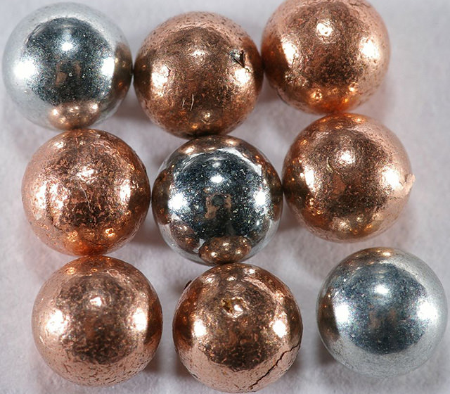

Metals are materials without diffuse scattering, but with an intensive reflection. The diffuse scattering of metals is close to 0, which is black. We see metals only due to reflected light which is colored the surface color.
For example, gold has black diffusion and intensive reflection of yellow color, copper has intensive reflection of red color, silver has intensive reflection of white color.

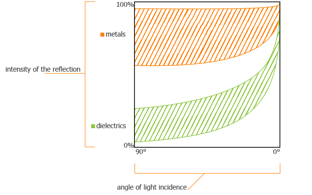

Fresnel Effect#
Another important concept is the Fresnel effect. The less the angle of light incidence on the surface, the stronger the intensity of the reflection of this light would be.
At the angle of 90 degrees (perpendicularly to a surface), different materials reflect with different light intensity. Dielectrics reflect from 0.05 to 30 percent of the light, while metals reflect from 55 up to 95 percent.
At the angle of 0 degrees, all materials are capable of reflecting 100 percent of the light.

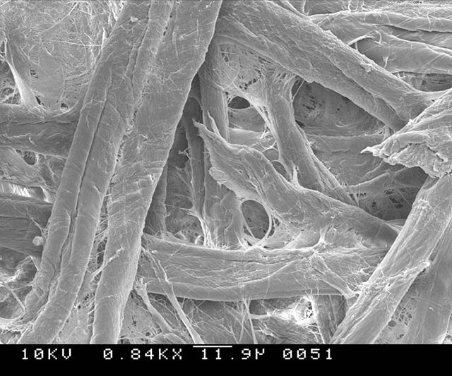

If we look at most materials under the microscope, we will see that their surfaces consist of a large amount of small particles which affect the light reflection from the surface. In other words, the surface is rough.
A scan of filter paper magnified 840 times under a scanning electron microscope (commons.wikimedia.org) / CC BY 2.0
Because of the roughness of the surface, light rays bounce in different directions, and the rougher the surface, the bigger the deflection amplitude of the light rays is. Consequently, the bigger the deflection amplitude, the more “blurry” the image is.

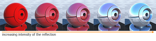

Physically correct render also considers the energy conservation. That means both diffuse and reflection light intensity should not be greater than the intensity of the light that drops on the surface. Thus, the more the reflection intensity, the less the diffuse light intensity (diffuse light is becoming darker). Only dielectrics have this effect, because metals have black diffuse reflection.

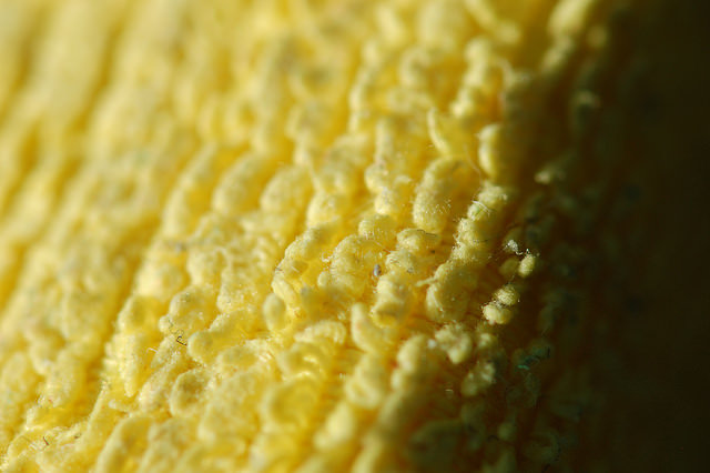

Microfiber#
Another important parameter of UNIGINE PBR material is microfiber, that simulates the napped surface.
Yellow Microfiber Sponge (flickr.com) / CC0 1.0

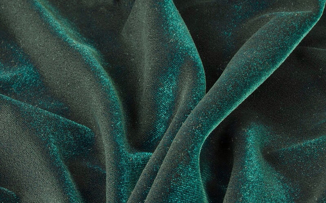

That nap (pile) is made of a large amount of strands with small length. If we create a napped surface (fur, fluffy material) as a geometry, it will be impossible to handle that surface in real time. Microfiber parameter of the PBR material simulates the light reflection on the napped surface. The point is the engine creates shading between strands of fur. But when the light is perpendicular to the microfiber surface, the surface become brighter. Because of this effect, a velvet sphere surface will be highlighted along borders.
Green Velvet (flickr.com) / CC BY 2.0
