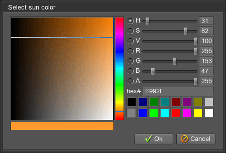

  1. Press N to go to the Node Settings -> sun node -> Light tab. Click on the Color field to change the light color used to illuminate objects in the world.
    Set the color values as shown at the picture.
    Click Ok to close the dialog window.
