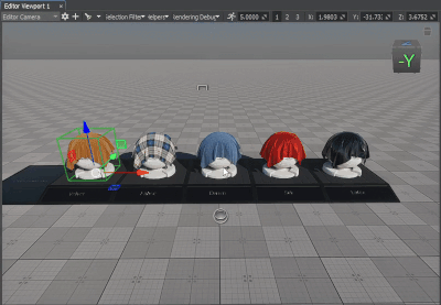

To select a single node in the scene, choose on the Positioning panel (or press Q) and click the left mouse button on this node. In this case, only the mesh surface you have clicked is selected. To select several mesh surfaces, hold Shift and click required surfaces.

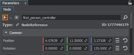

You can convert the selected node to a NodeReference by pressing Ctrl+Shift+G (or click Edit -> Convert to NodeReference).
To select several nodes, do either of the following:
  • Use the selection box: click and hold the left mouse button, drag the mouse to select the required nodes. In this case, all surfaces of each mesh (if they exist) are selected.
    Select using Selection Box

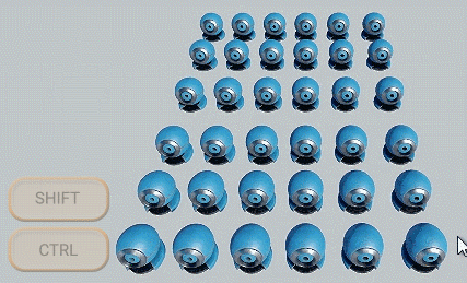

  • Select one of the nodes, press and hold Shift to add nodes to the selection and Ctrl to remove.
    Add and remove nodes from selection

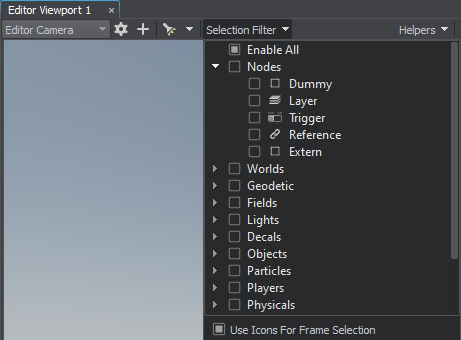

The viewport window has the Selection Filter dropdown that allows defining which types of objects are to be selected by a selection frame and if icons should be used instead bounds for selection (the Use Icons For Frame Selection option).
Selection Filter

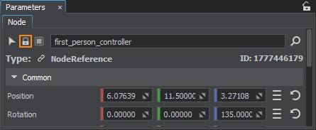

By default, any node in the world can be transformed. However, you can toggle transformations of specific nodes on and off using the Transformation flag in the World Nodes or Parameters window.
Transformation Flags in World Nodes Window
Transformation Flag in Parameters Window

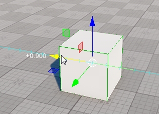

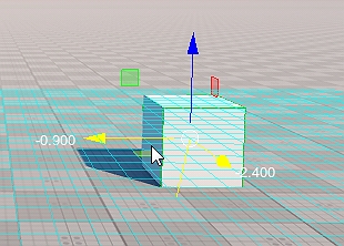

Move Nodes#
To move the node:
  1. Choose the manipulator on the Positioning panel (or press W).
  2. Click the required node. The axes along which the node can be moved will be shown.
    Move Node
  3. Move the node:
    • If the arrow manipulator is dragged, the node can be moved along the selected axis.
    • If the rectangle manipulator is dragged, the node can be moved by two axes.
    • If the circle manipulator is dragged, the node can be moved in the screen plane.
    Move along 1 axis
    Move by 2 axes
    Move in the screen plane

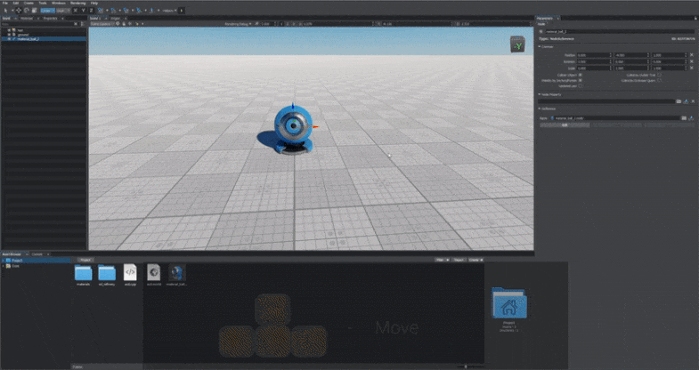

You can also move the selected node by pressing the arrow keys:
  1. Choose the manipulator.
  2. Enable snapping by grid and specify the movement step. Step can be set either by direct input of digits or using the box as a slider.
    If snapping by grid is disabled, the node is moved by 1.0 unit.
  3. Select the node you want to move in the viewport. Move the node using the arrow keys. The direction of movement is projection-dependent.

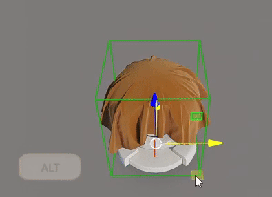

  • Ignore the node's hierarchy when moving the selected node: press Alt and move the node without its children.
  • Move the selected node to the camera by pressing Alt+X.

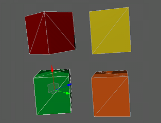

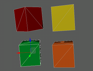

Rotate Nodes#
To rotate the node:

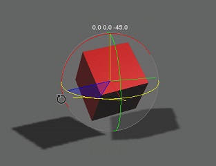

  1. Choose the manipulator on the Positioning panel (or press E).
  2. Click the required node. The sphere with the axes, around which the node can be rotated, will be shown.
    Rotate node
  3. Rotate the node:
    • If an axis of the sphere is dragged, the node is rotated around the axis.
    • If the sphere is dragged, the node can be rotated freely around several axes.
    Rotate around 1 axis
    Rotate freely

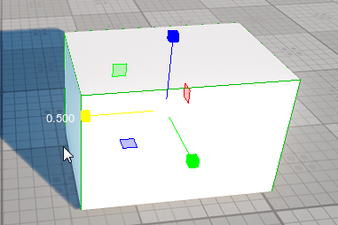

Scale Nodes#
To scale the node:

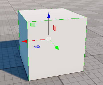

  1. Choose the manipulator on the Positioning panel (or press R).
  2. Click the required node. The axes, along which the node can be scaled, will be shown.
    Scale Node
  3. Scale the node:
    • If the red, green, or blue cube manipulator located at the end of any axis is dragged, the node is scaled along this axis.
    • If the red, green, or blue square manipulator is dragged, the node is scaled along two axes.
    • If the white cube manipulator at the origin is dragged, the node is scaled along three axes.
    Scale along 1 axis
    Scale along 2 axes
    Scale along 3 axes

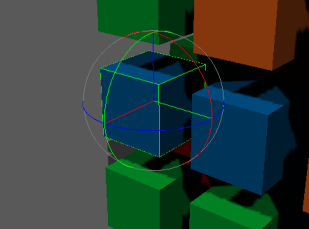

Pivot Point and Coordinate System#
Transformations of the node are relative to the pivot point. The pivot point is used to control the way nodes rotate and scale.

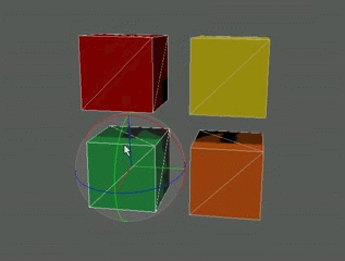

To rotate or scale several nodes, select them, choose the required manipulator, and specify the position of its pivot point by using the pivot point toggle.
If one node is selected, the pivot point position will not change when toggling.
  • If the button is active, the pivot point is set to the center of selection.
  • If the button is active, the pivot point is set to the center of the last selected node.
To toggle the pivot point, you can press Z.

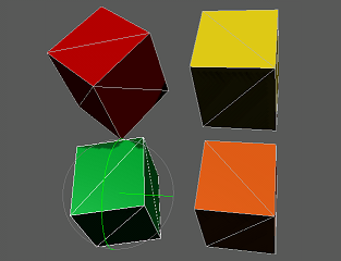

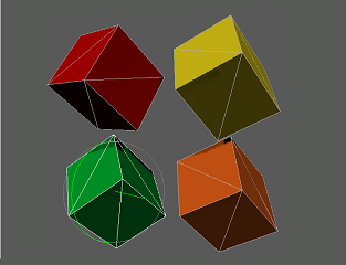

For example:

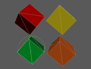

  • If you select several nodes, set the pivot point toggle to Center, and rotate these nodes, they rotate around the center of selection as follows:
    Pivot point in the center of selection
    If you scale the nodes, they are scaled out from or in toward the center of selection.
  • If you set the pivot point toggle to Pivot and rotate the selected nodes, each node will rotate around its center as follows:
    Pivot point coincides with the center of the last selected node
    If you scale nodes, each node is scaled relative to its center.

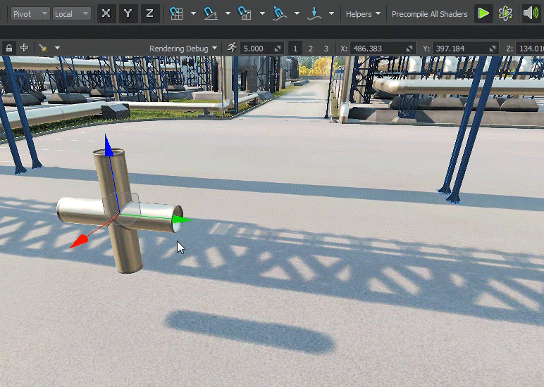

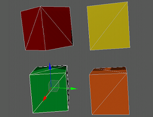

The basis of the manipulator pivot point can be toggled as follows:
  • If the button is active, the world space orientation is used for the manipulator pivot point.
    For example, if you set the combination for the selected nodes and rotate them around the Y axis, you will get the following:
    Before rotation: After rotation:
    Pivot point is oriented by the world space
    Nodes have been rotated by 45 degrees around the Y axis
  • If the button is active, the coordinate system of the parent node is used for the pivot point orientation.
    Pivot point is oriented by the local basis of the parent
    node (the red cube)
  • If the button is active, the pivot point is oriented by the local coordinate system of the node. It means that its orientation does not depend on the parent node orientation.
    The pivot point is oriented by the local basis of the last
    selected node (the green cube)
    The nodes have been rotated by 45 degrees around the Y axis
To toggle the manipulator basis, you can press Z.

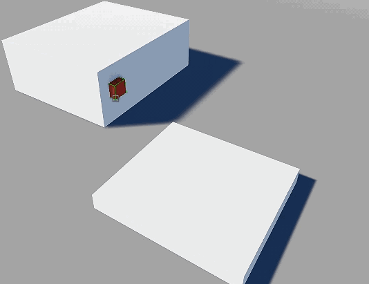

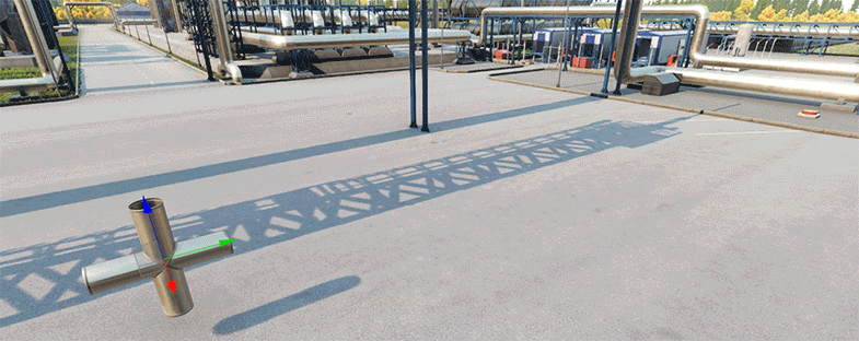

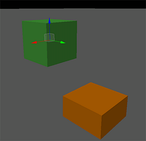

Snapping Nodes to Surface#
Snapping a node to a surface of another node provides pixel-perfect positioning of the nodes relative to each other.

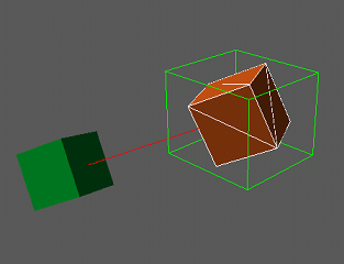

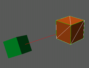

To snap a node to the surface:
  1. Select a node that should be snapped.
  2. Choose on the Positioning panel (or press Alt+W).
  3. Specify snapping settings via the following panel:
    Option Description
    Offset from Surface
    Specifies the distance from the node's pivot point to the surface (in units).
    • To increase/decrease the distance to the surface, use the WHEEL UP/WHEEL DOWN hotkeys.
    • To reset the distance to the surface, use the MIDDLE CLICK hotkey.
    Orient by Normal
    Specifies whether the node should be oriented by the surface normal.
    The hotkey is RIGHT MOUSE BUTTON.
    Take Intersection Into Account If enabled, the node interacts only with the surfaces that have the Intersection option enabled.
  4. Move the node until the red stripe intersects the required surface of the other node. Click the left mouse button to place the node.
    To abort placement, press ESC.
The node will follow the mouse as on the image below:
Node is oriented by normal
Node is not oriented by normal

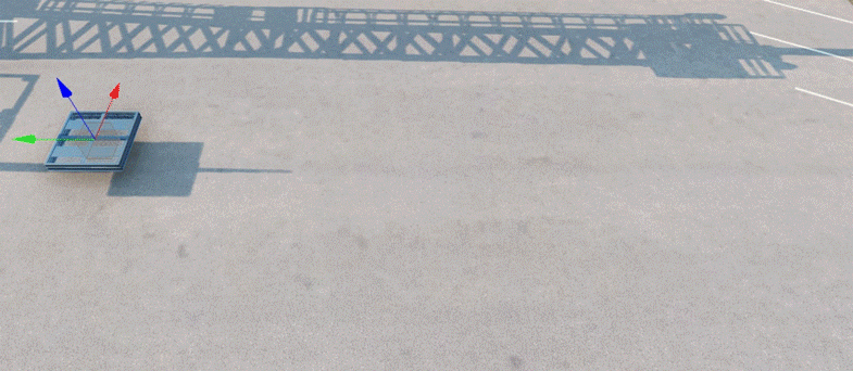

Dropping Nodes to Ground#
Dropping a node to the ground means positioning a selected node to the surface below or above this node.
To drop a node to the surface:
  1. Select a node (or several nodes) that should be dropped.
  2. On the Positioning panel, find and specify the required settings in the drop-down window:
    Option Description
    Direction
    Specifies the direction of dropping:
    • Up — find the closest surface above the object.
    • Down — find the closest surface below the object.
    • Up And Down — find the closest surface below the object and above it.
    Offset from Surface Specifies the distance from the node's pivot point to the surface (in units).
    Orient by Normal Specifies whether the node should be oriented by the surface normal.
    Intersection Mask
    Sets an intersection mask that defines whether a node (or nodes) will be positioned on a surface to which it is dropped.
    A node will be positioned on a surface if they both have matching intersection masks. Otherwise, the node will penetrate the surface.
  3. Click to drop a node (nodes).
    Initial position of a node
    Node dropped to surface (default settings)
