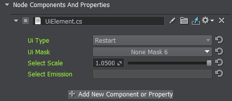

  4. Assign a UiElement component to the child restart_button node.
  5. Set the Ui Type to Restart, check the 6th bit option for the Ui Mask (matching the button's Intersection Mask) to correctly process selection intersections and set the Select Scale to 1.05 in order to make buttons bigger on cursor hover. Also, set the Select Emission to #505050 to make the button change its color.
  6. Set up a new UiElement component the same way for the exit_button, but set the Ui Type to Exit.
